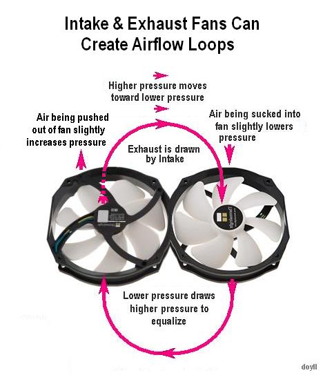

Also, having 2x different orientation fans side-by-side creates airflow loop as well, making any cooling actually worse. Image to explain it:
Oh, you don't have to create negative pressure inside your PC case. As long as you run your intake fans higher speeds than exhaust fans, you'd get neutral or even positive pressure.

That's what I needed to see!
