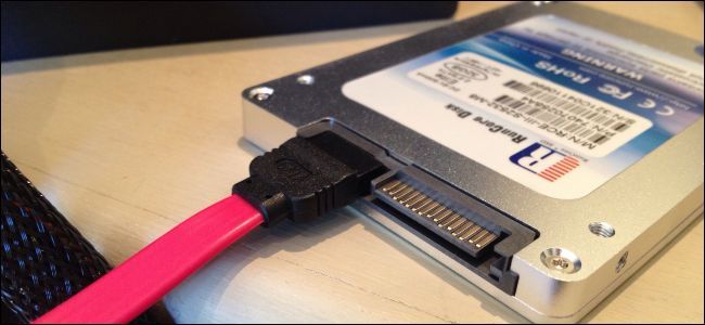

Solved it!
I sent these benchmarks to WD, who asked me to send event viewer and msinfo reports. They got back to me with:
“Based on the information you provided, it does appear that the partition is not 4K aligned. This kind of issue can be caused by bad cloning or OS installation and can affect the drive's performance. Unfortunately, we are not able to assist with correcting this issue. But there are third party utilities that you can look into that should be able to correct this issue without needing to re-partition the drive”
A quick google and I was able to fix it following this guide:
And now have:
Thanks everyone for your help with this.
