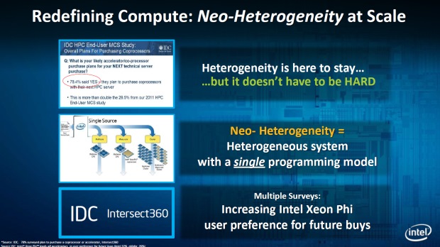

I bolded the relevant part above. Intel consider its KL belong to heterogeneous computing
http://news.softpedia.com/news/Intel-Launches-Knights-Landing-Xeon-Phi-PCIe-Coprocessors-361583.shtml
http://www.v3.co.uk/v3-uk/news/2275261/intel-announces-14nm-knights-landing-processor-in-xeon-phi-update

It's always going to be heterogeneous as the primary model is Xeon + Xeon Phi. If you're just working on Xeon Phi then that is homogeneous.
