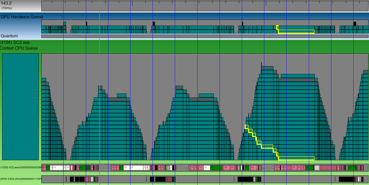

Tools like GPUView, which shows you this information, allows you to see, at least, how many process heavy threads are being run, how often they run, how much work they do, and what cores they get dispatched to. Very few people have used this in any real way for games yet, though if I can get the SDK to properly install, I might do some investigation in this area in the future...But just a few quick examples (Since noob won't let the SC2 argument die a quite death):
http://graphics.stanford.edu/~mdfisher/GPUView.html
Note SC2 does the majority of its work on two threads (light workload threads aren't displayed by default). But notice how many times the thread jumps cores (different color = different core), which is to be expected to some extent (The OS can come and kick out a user thread anytime it wants to). And note the second thread doesn't begin until later in the processing cycle (probably the render thread, based on the fact the render entry is d3d9.dll). I would imagine Task Manager would looks pretty close to what I described above: Two threads loading three cores to some extent. Hence why I don't view Task Manager of a real good indication of threading within an application.
