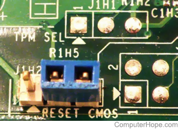

Don't need to take battery out, just short posts labeled CLR_CMOS on the MB.
Ngl, sometimes battery is easier to access compared to this jumper, but power supply must be off and system attempted to power cycle to release charge. On other side, battery removal timing are atrocious, sometimes even after few minutes my CMOS won't reset, so jumper is much more reliable (i access it with tip of knife usually)

no, I tried to replace the CMOS but it's not coming out, I'm pretty new to pc building and stuff so excuse me if it's a dumb question but how do I reset the CMOS?
2 ways to do it.
First way
  1. Turn off power supply
  2. Remove power cord
  3. Find battery on motherboard and remove it
  4. Press power button on PC (still without power)
  5. Wait around 2-3 minutes.
  6. Press power button again
  7. Put battery back
  8. Put power cord and turn on power supply
  9. Start up PC
_
Second way
  1. Find something metallic and thin, like knife, scissors, etc
  2. Find on motherboard 2 metallic pins as jumper with CLR_CMOS or RESET CMOS written around it
3.. Short it (put metal to connect these 2 pins).​
4.. Start up PC​
