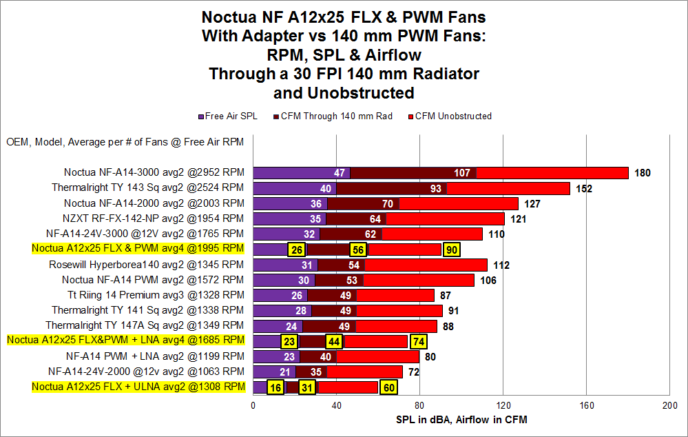

This is a fairly interesting chart, from the overclockers.com review of this fan, seems to outperform the 140mm NF-A14 PWM on the test rad used, and with less noise. This is with their NA-SFMA1 adapter, though.
https://www.overclockers.com/noctua-nf-a12x25-fan-review/
Yes, but in regards to the D14, the Noctua NF-A14 2000rpm fans have 176% more static pressure and 58% higher CFM than the NF-A15 fans do. The static pressure, when used on a heatsink or radiator, will usually be the telling factor when other specifications (normally tested under free air conditions, not with a major restriction) are otherwise equal.
120mm fans are NORMALLY often found to have higher static pressures than similar spec'd 140mm fans, but in this case the iPPC fans are far beyond what the A12x25 offers.
I have the A14 2000rpm iPPC fans on my NH-U14S and the maximum PWM overclocked temperature in Prime95 testing dropped by 8°C with two of them on the heatsink versus only one NF-A15 that it came with. That's a significant decrease in thermals.
Considering it is only a slim style single finstack heatsink, you can assume the difference might be higher on the twin finstack D14 or D15, or any much larger heatsink. But I think the A12x25 fans are pretty terrific as well and will absolutely be a quieter option.
