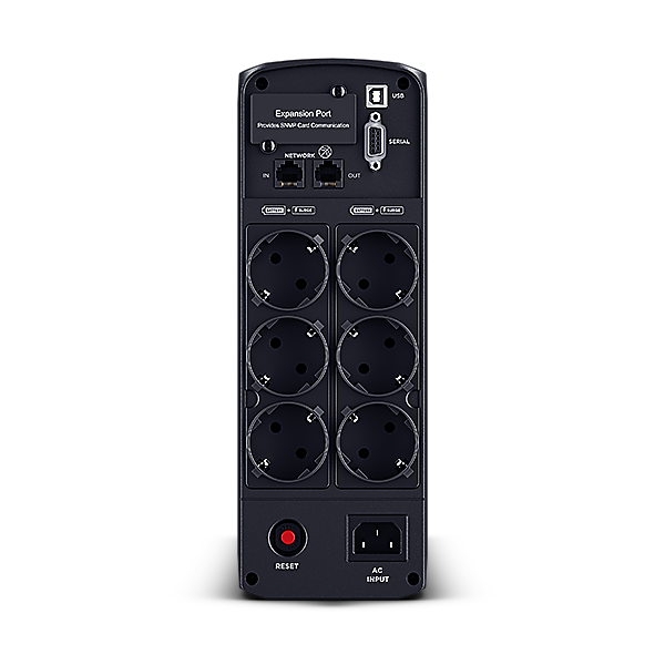

Well, compare the specs;
APC BGM2200B-GR, specs: https://www.apc.com/shop/hr/en/prod...-Pure-Sine-Wave-Midnight-Black-/P-BGM2200B-GR
CyberPower CP1600EPFCLCD, specs: https://www.cyberpower.com/eu/en/product/sku/cp1600epfclcd#specification
Differences;
Capacity:
APC - 2200VA/ 1320W
CyberPower - 1600VA/ 1000W
Recharge after full drain:
APC - 16 hours
CyberPower - 8 hours (to reach 90% charge)
Runtime:
APC - ??? (runtime chart doesn't open for me, so, i don't know the values)
CyberPower - 2.6 mins at 1000W load; 9.7 mins at 500W load.
Surge suppression (up to):
APC - 1080 Joules
CyberPower - 405 Joules
Input ports:
APC - 1x IEC C20
CyberPower - 1x IEC C14
Output ports:
APC - 2x IEC C13 with battery + surge protection; 2x Schuko with battery + surge protection ; 2x Schuko with only surge protection.
files
Direct link if image doesn't load: https://download.schneider-electric...S_2200B_GR_B_V&p_File_Type=rendition_1500_jpg
CyberPower - 6x Schuko. ALL protected by battery + surge.
e5e81d36-cf37-492b-b015-677630e554d9
Direct link if image doesn't load: https://www.cyberpower.com/eu/en/File/GetImageByGuid/e5e81d36-cf37-492b-b015-677630e554d9
Noise:
APC - 45 dB(A) at 1m.
CyberPower - 0 dB(A). *
* Noise isn't stated on CyberPower UPS specs, but if i take my UPS as baseline, which is predecessor of the one in current comparison, then i can say that my UPS noise output is 0 dB(A). Meaning, it is dead silent. When it switches to battery power, a LOUD alarm starts beeping, letting you know that main power went out, so, you can save your work and shut down your PC.
Conclusion; despite them both being true/pure sine wave and line-interactive topology UPSes, there are differences between the two.
Your call which one to pick.
Personally, i'd go with CyberPower, since it has far better selection of output ports than APC has them.
With APC, two ports are dedicated for PC use (IEC C13) and you may need to buy IEC C14 to IEC C14 cable as well, since, e.g my PSU cable has Schuko on the other end and not the IEC C14 female plug.
Also, two of the Schuko sockets on APC only have surge protection, without no battery backup. These two Schuko sockets act like glorified surge protection.
With CyberPower UPS, all it's output sockets are Schuko and there is no issue of buying dedicated cable. Also, all output ports are backed by battery and surge protector. So, IMO, CyberPower is more convenient to use.
Differences;
Capacity:
APC - 2200VA/ 1320W
APC - 16 hours
Runtime:
APC - 1080 Joules
Input ports:
APC - 1x IEC C20
Output ports:
files
Noise:
I've just compared the power use in 1320 W APC model and in 1000W CP model, and you know what ? When I compared the power usage between these two models that had difference in watts, it sure as hell shown no real difference, here are the differences:
CYBER POWER - > View: https://imgur.com/a/1gjIuP9
APC - > View: https://imgur.com/a/UM1Nb6a
