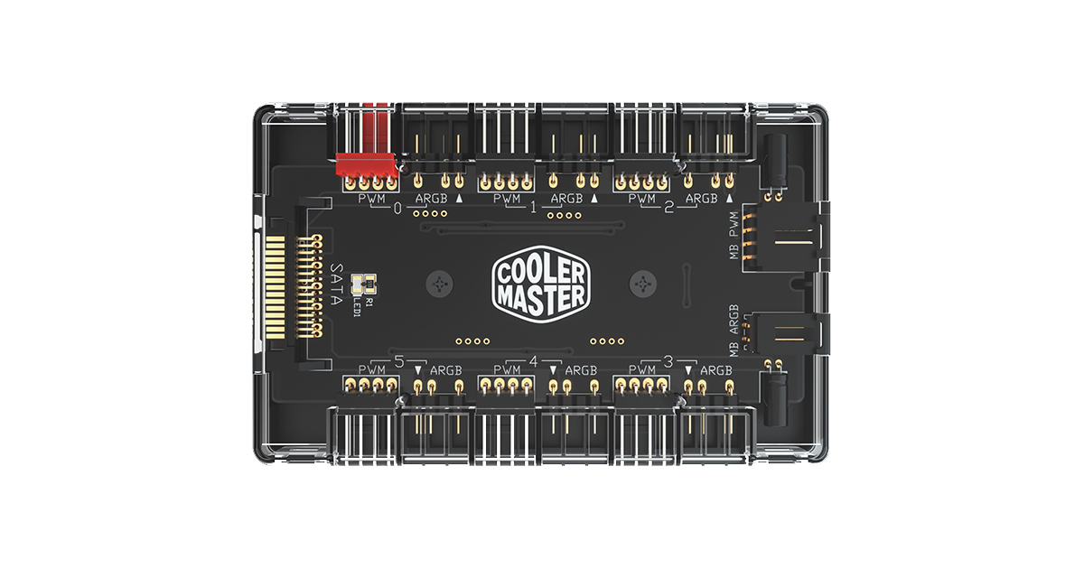

Lutfij points you in the right direction, but I'll add a couple details. You recognize already that you need power and control for two things - PWM fans and ARGB lights - and want to centralize all that in one Hub. Also, you have no lighting headers on your mobo. What that means, then, is that you need two devices. You need the Hub for both functions, and Lutfij has pointed you to one by CoolerMaster, also available here for example
https://www.amazon.com/Addressable-Lighting-Magnetic-backplane-Addressble/dp/B08JQFKXYK/ref=sr_1_3?crid=38CAMOFAVJU4T&keywords=cooler+master+fan+hub&qid=1644259571&sprefix=cooler+master+fan+hub,aps,92&sr=8-3
and a cheaper version here
https://www.amazon.com/Addressable-Lighting-Splitter-Motherboard-Interface/dp/B08GCD71CG/ref=sr_1_5?crid=2DTU2KFIZGXVF&keywords=fan+hub+argb&qid=1644259659&sprefix=fan+hub+argb,aps,72&sr=8-5
I note also that OMNI sells another of this type on their website.
Then you also need a third-party ARGB lighting controller and Lutfij has listed one with a few extra features. That's an older model for which I have seen conflicting claims about use with software. However, Cooler Master has a new model, their LED Controller A1
https://www.amazon.com/Cooler-Master-Addressable-Controller-Individual/dp/B09NQFZNFT/ref=sr_1_1?crid=2N0CLKUVC7OHS&keywords=Cooler+Master+LED+Controller+A1&qid=1644260102&sprefix=cooler+master+led+controller+a1,aps,93&sr=8-1
It is designed from the start for just what you want - power and control of ARGB lights only, using a USB2 connection for communication with their free software utility Masterplus+. Another very similar alternative is the Razer Chroma Addressable RGB Controller using their Synapse 3 software.
https://www.amazon.com/Razer-Chroma-Addressable-Controller-Compatibility/dp/B08KC2VZ2V/ref=sr_1_15?crid=2EFSLB5L97WND&keywords=ARGB+Controller&qid=1644260206&sprefix=argb+controller,aps,86&sr=8-15
With either of the combo (fan + lights) Hubs you connect to it a power supply (a SATA power output from the PSU), a cable from one mobo SYS_FAN or CHA_FAN header to bring in the PWM signal, and a cable from the output of one of those ARGB lighting controllers to bring in the ARGB control signals. Then you connect from each fan or light strip the fan motor cable and lighting cable to the appropriate Hub output port. You configure your mobo fan header for use with PWM 4-pin fans, and you install and run the software tool for your Controller to manage the lights. Ta-Da!!

Re-read the last half of my post above. The Hub you are aiming for IS good for what you want - but it's just HALF of what you need. A HUB can only distribute power and control signals to all its attached devices. It is NOT a Controller by itself, so it does NOT create its own control signals for either function. That is an interesting Hub design because it is a combination of TWO types of Hub. One half of it is for the MOTORS only. The other half is to distribute the signals for ARGB Lights.
As Karadjne says above, each lighted fan you have is TWO separate devices in one unit - a fan with motor, and lights in the fan frame. Each has its own separate electrical cable ending in a "standard" connector you can plug into any "standard" fan header and lighting header. The motor cables from each fan plug into the "PWM" ports of that Hub. The Lighting cables from each fan plug into its ARGB ports. In addition to the power supply from a SATA power output connector from the PSU, the Hub requires inputs from TWO sources: one from a mobo fan header to get the PWM control signal for the MOTORS, and another from an ARGB Controller for the control signal for the LIGHTS. Your mobo has no Controller and header built into it for lights, so you need a third-party CONTROLLER for ARGB lights. THAT will provide the control signals you must feed to the Hub for the lighting functions to work. Lutfij linked you to one in his post above, and I recommended two others for you to consider.
