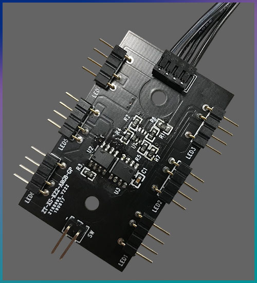

My case is MSI MAG FORGE 100M (https://www.msi.com/PC-Case/MAG-FORGE-100M) and it comes with a "1 to 6 RGB LED Control Board", now, I've had this case for a while, but I would like to have control over my ARGB fans in my system (via software), so far I have been changing the colors via the case button, thus I do not have the control board connected to my motherboard, and that is what I would like to change.
My motherboard is GIGABYTE B550 GAMING X V2 (https://www.gigabyte.com/Motherboard/B550-GAMING-X-V2-rev-10-11-12#kf), Gigabyte is advertising that you can connect LED strips to it, but that's not what I want, and this is where I became uncertain, how should I connect the control board to the motherboard? From what I have been googling, it appears I should connect it to the "D_LED1", is that correct? Keep in mind I want the whole hub connected, not single fans, to have control over the ARGB system.

I mean, it's not what I expected to see, is it even possible to connect it to mobo?
This is different than shown on PC case specs page;
Where promotional image shows 4 wire connector for control, indicating that at the other end, there is standard 4-pin RGB connector. However, your image shows the connector for control just to have 2 wires, whereby the LED button acts just as a on/off switch. In this case, you can not connect the hub to the MoBo, since there are no internal headers for 2-pin wires, that can be toggled via software.

I mean, it's not what I expected to see, is it even possible to connect it to mobo? I haven't checked the other end yet, just a quick peek.
Now, all is not lost, since you have 2x RGB fans and 2x RGB headers on MoBo, whereby you can bypass the RGB hub completely and connect both fan LED cables directly to MoBo. This way, you can have individual control over fan RGB. E.g make one shine blue, while other shines red.

I have noticed this too, and I feel a little bit scammed, I bought it new and from a legit (and the biggest) shop in my country, both the shop and MSI are showing the same picture, yet the board I have is different.
I have checked the order, it is indeed the MSI MAG FORGE 100M.
It is only half-lost, because I bought more of these RGB fans, so I cannot connect them all, I know now that I would have to buy either a splitter or a new hub for them.
Anyways, if the board was as shown, your instructions would've helped and solved it, but you did helped a lot without that, so thank you, marking as solution.
