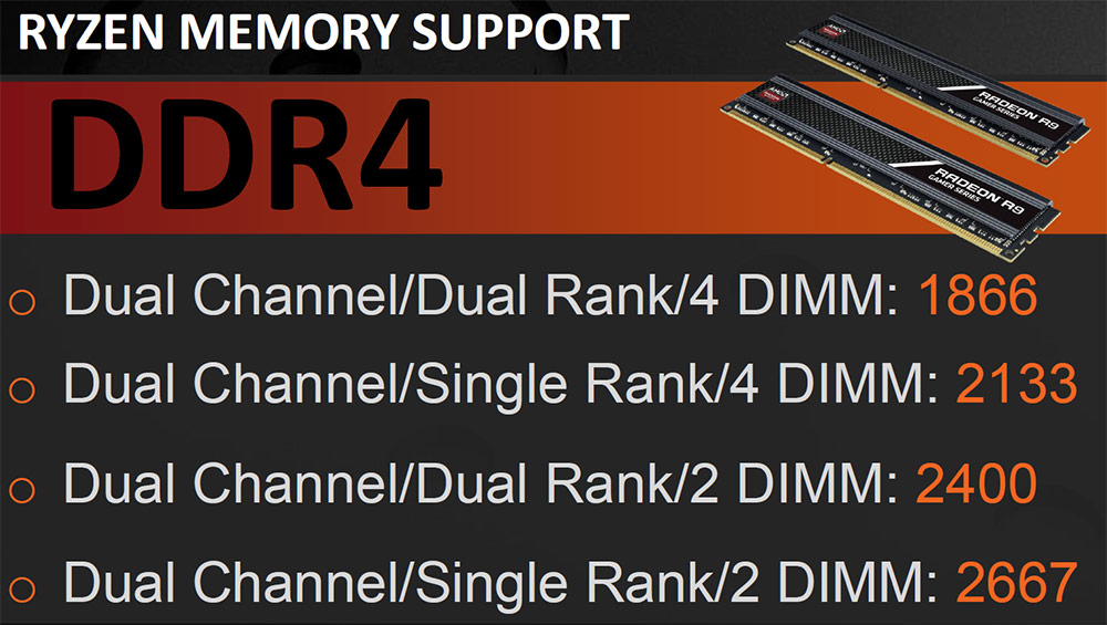

I had the same problem with my kingston savage 2800Mhz, i found in the spec sheet that ryzen supports as follows
On short for 4 DIMS memory max 2133 for 2 DIMS memory max 2666. My case is 4 DIMS (i got 4 stick of ram at 2800).

Ok let try again maybe i get heard this way, there are only three motherboards which supports bclk overlock(which you need to support higher ram right now), any other mid-entry low-end motehrboard DOES NOT SUPPORT RAM HIGHER THEN 2666 with two stick and higher then 2400 with four stick if you are lucky, no matter what it says in the box or on the website.It is a new product which is not fully polished and needs some time to be compatible, at least what they told us now we wait and see. Or go and pay 400$ for a motherboard and you can boot at 3000 mhz. In my case even with two stick can t boot at 2400 not even 2666.
If you dont believe me go here and check yourself, be sure there are 2 compatibility column, default ram and ryzen also you got at the end dots to specify with how many dimms works at that frequency. https://www.asus.com/us/Motherboards/PRIME-B350-PLUS/HelpDesk_QVL/
