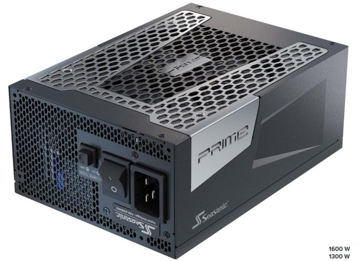

SeaSonic, who probably makes these ASUS units, already make 115v PSUs that nudge 96% efficiency and are whisper quiet (using their TX-1300 as an example), so there's not exactly a great need for them to switch to GaN, whose biggest strengths are compact dimensions and high switching frequencies (wall adapters and wireless chargers), though they're likely found in their new flagship, the 230v PX-2200.
I know some of the better brand name PSUs have previously been Seasonic rebadges, but I haven't seen much of that, lately. Is Seasonic known to be developing GaN, or what reason do you have for assuming Seasonic is the manufacturer?
