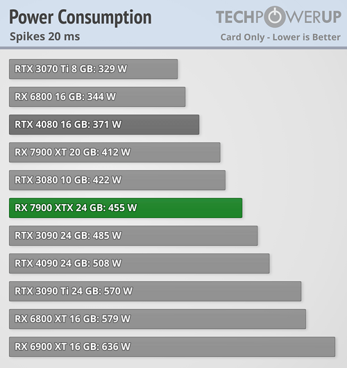

I don't really see a problem. Your PSU can handle it and your case has 381mm of video card clearance which is more than enough for even the largest RTX 4080 available in New Zealand, the Zotac GeForce RTX 3080 AMP Extreme Holo 16GB at 356mm.
I would personally take an RX 7900 XTX over an RTX 4080 (and I did) for the lower price and 24GB of VRAM but I can see that in NZ, the price difference between them is tiny so the RTX 3080 is a much better buy there than here in Canada.
You should just be able to pop it in and go. I can't foresee any problems with your current build. Your i9-9900K would be a bottleneck at 1080p but nobody buys an RTX 4080 to game at 1080p (unless they belong in the loony bin). You're good to go! 😉👍

I agreed with @Phaaze88 concern on whether it'll fit the 12VHPWR connector safely. In terms of width, at best you'd only have around 170-180mm, and something like Zotac Trinity 4080 is already around 150mm long, so you wont make the safe slack as instructed of around 25-45mm. You either want to run the revised 16-pin cable, or get a 90 degree adapter to play it safe. Although i do have seen people run the same setup like yours without 90 degree adapter easily, but as i state, not ideal.
