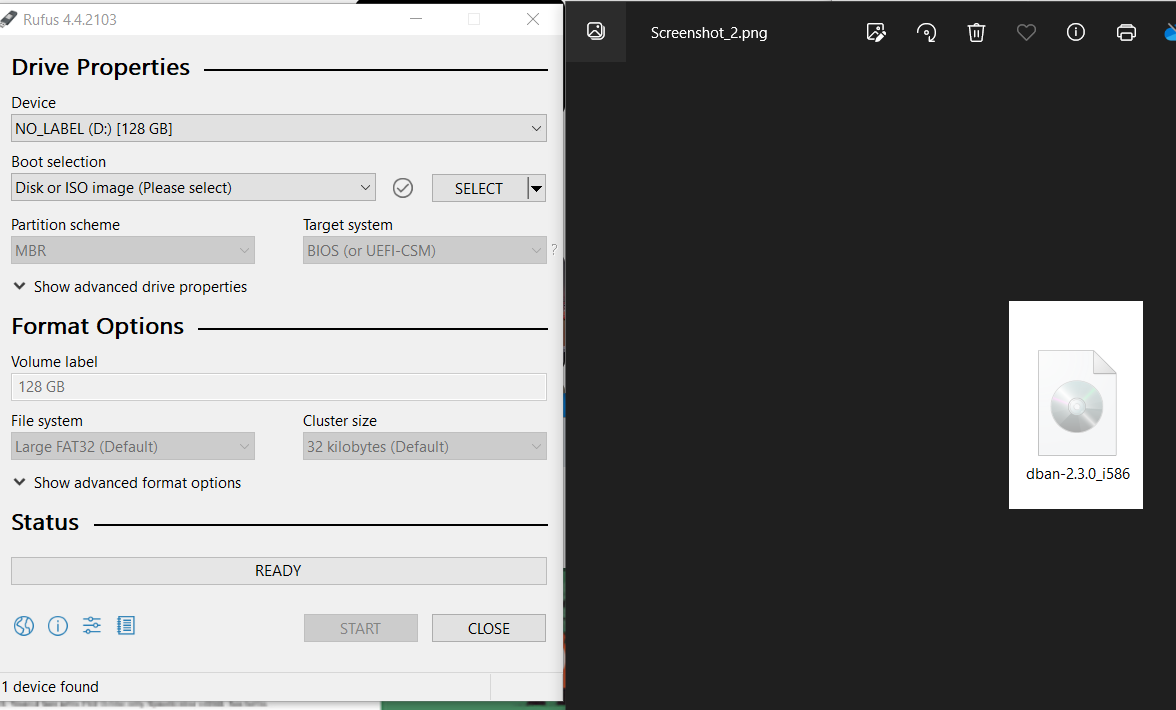

Ok then, what's the easiest disk wiping utility you guys can recommend for me to wipe the drive please? I am seeing:
You can create a bootable USB drive or CD/DVD with a disk wiping utility like DBAN (Darik's Boot and Nuke) or use installation media for a new operating system.
Since I already have a win10 bootable flash drive, work that work to effectively wipe the drive please?
Reactions: artk2219
You can boot directly from a DBAN USB.
