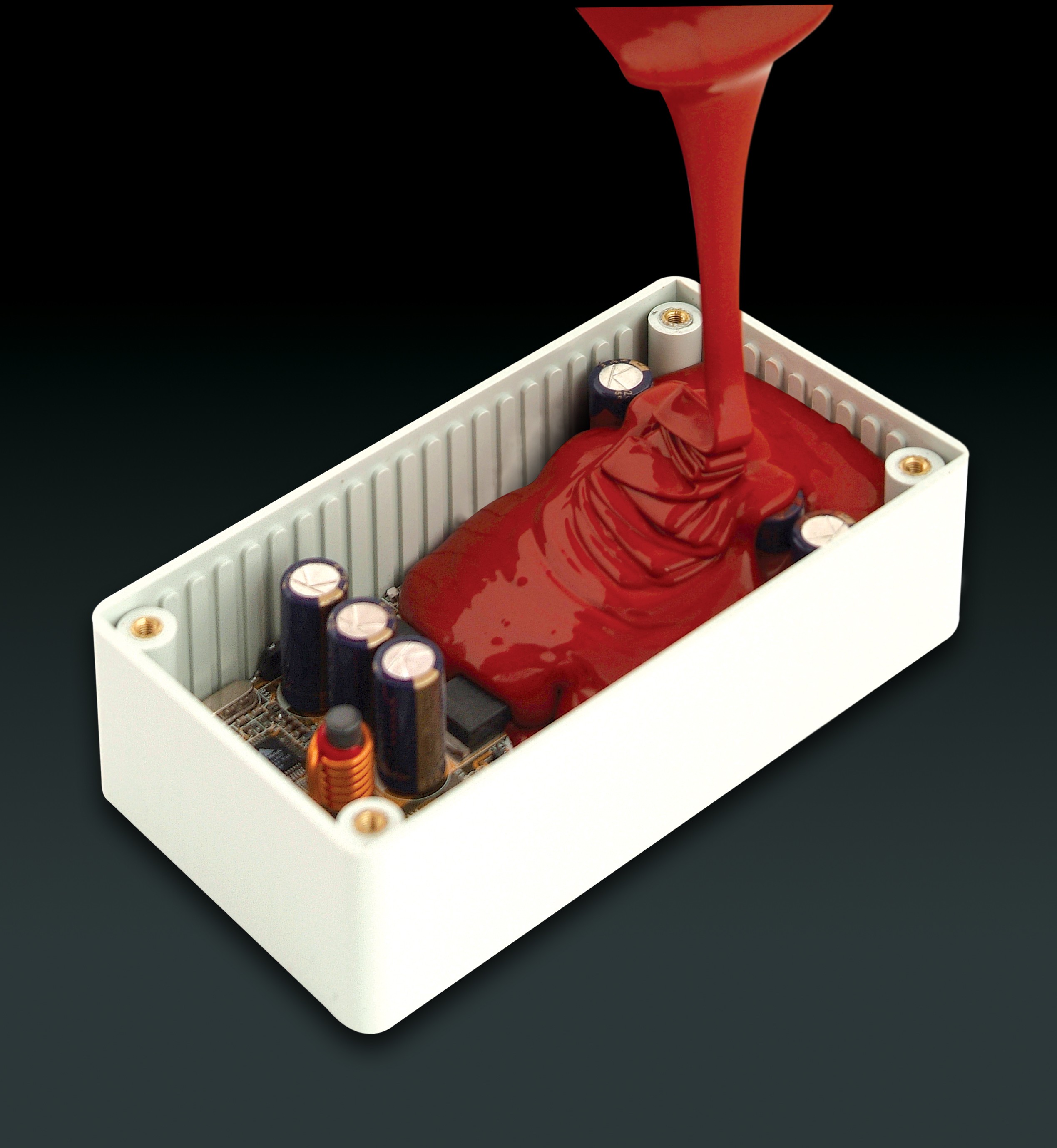

But can you rubber coat a transformer? I would think it would disrupt the magnetic field it generates.
The rubber will have zero effect on the magnetic field. Transfomer cores are made from iron laminations for 50/60Hz, or ferrite for high freqencies. Rubber is "transparent" to magnetic fields.
I've used small 600 Ohm 1:1 audio isolating transformers where the bobbin was protected by a thin layer of pink Silicone Rubber, probably designed to prevent water ingress into the windings, in humid atmospheres.
I wouldn't apply large amounts of rubber to a mains transformer or a standard computer PSU. Too much risk of overheating, followed by smoke and fire.
https://makerindustry.com/what-is-kapton-tape/
Silicone encapsulants are used in certain circumstances, but generally in circuits which do not generate significant amounts of heat.
https://cht-silicones.com/products/encapsulants/general-silicone-encapsulants
