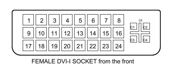

intergrated graphic isnt enabled, your cpu doesnt have one
so it means something is wrong with your dvi output or dvi adapter
there is reserved pin for detecting monitor (pin16), if monitor isnt detected on dvi it would lead to displaying on vga port (in bios), windows doesnt use it
