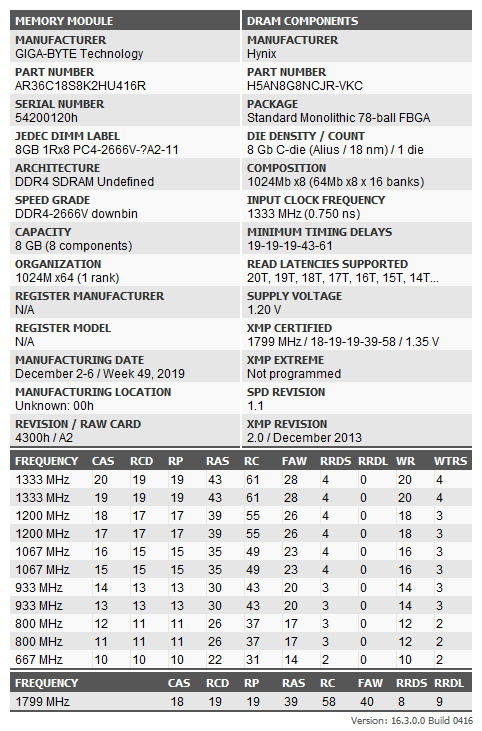

View: https://imgur.com/TRvWsPr
View: https://imgur.com/IgbJaV3
