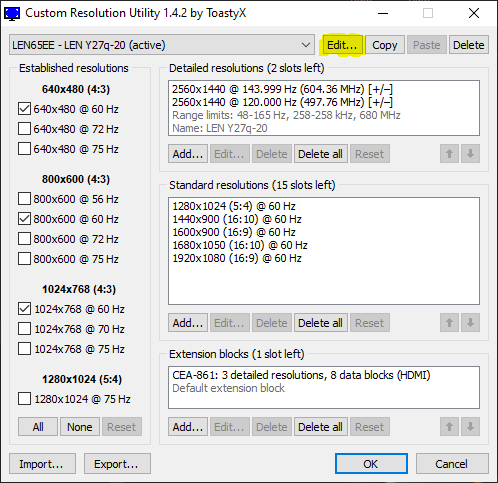

I have intermittent nvlddmkm with temp monitor black screen since my first new build a week ago. Every time during Youtube, the few hours I have gamed no issues. I'm still looking into it but mine is fixed with a (temporary?) patch using CRU. This patch is monitor specific though.
Ryzen 5 3600x | RTX 3070 FE | MSI Tomahawk X570 | Crucial Ballistix 3600 CL16 4x8 gb | Seasonic Gold+ 750w | Lenovo Y27Q20 | Windows 10 Pro
I have hwinfo charts showing data from crash but unsure if it exhibits hardware faults or a rebooting GPU from normal TDR reboot. With the following "patch" installed I do not get nvlddmkm so I feel it must be firmware/driver/settings within monitor, GPU, or Windows 10 Pro.
