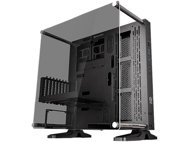

To be brief - I'm looking for a case as in the photo in my last message, only with more or less closed sides.
Sounds like an open air bench would fit the bill, but then there's the cat... a dilemma, that is, what with the pet hair(will need fan filters), and if it ever decides to stick it's head or paws inside...
So the case must be closed.
Something more like this: https://pcpartpicker.com/product/V998TW/thermaltake-case-ca1d800f1wn00
But instead of the glass side panel, it should instead be a filtered panel.
