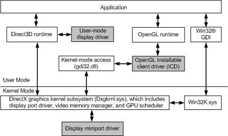

"Game-ready" drivers involve AMD engineers profiling new & popular games and optimizing the drivers specifically for them. That could mean optimizing a codepath in the driver that other games don't typically use, but I believe it can even involve effectively rewriting some of a game's shaders.
Not just performance. For Studio drivers which are intended for production-oriented environments, you likely also get more thorough regression testing to ensure new drivers don't introduce artifacts - nothing gets hurt by a flickering transparent layered texture in a game while days of work in a production environment may need to get redone if a new bug gets introduced in a production environment before getting spotted.
No... they don't use Direct3D for rendering Pixar movies.
As for bugs, I think game-ready drivers contain game-specific bug fixes, as well as optimizations. Sometimes, the bug is actually in the game, and the driver fix is merely a work around. This most often happens because the other brand's driver might have a bug or a quirk that the game is dependent on.
In the Linux/OpenGL world, AMD spent a long time making their drivers "bug-compatible" with Nvidia's. Sadly, this was needed mostly for professional applications that were developed solely using Nvidia's drivers.

The texture layering issue was just a simple example of an obvious bug that mostly doesn't matter for games which most people have likely seen many times and can easily imagine not being remotely acceptable for any sort of production output.
It's a nonsensical example, because what you mean by "production" lives in a different universe than the software stacks and rendering techniques used for games. Nobody is using hardware-accelerated, textured polys for feature films, or even special effects in television productions.
Sure, at some level, there's some device driver functionality that's common to both games & non-gaming code (to the extent anyone even does production rendering on Windows, which I doubt), but that's going to be separated from the D3D driver code that contains the rendering support for it and fancy optimizations used by games.
https://learn.microsoft.com/en-us/w...a-and-later-display-driver-model-architecture
What people use for hardware-accelerated rendering doesn't matter. The fact that new bug introductions in production drivers can wreck havoc on a production environment is. As I stated earlier, I used the texture layering example for illustrative purposes only - something every gamer is likely familiar with. It was never meant to represent actual production where far more subtle bugs in OpenCL, CUDA or whatever else that may not be immediately obvious could be far more devastating.
Your point is a non-sequitur for multiple reasons:
  1. The volatile bits of driver code where the game-specific fixes & optimizations occur would be in the user-mode display driver, not touching the parts used by the GPU compute APIs used for production rendering.
  2. Almost nobody is doing production rendering on Windows.
  3. If you're using GPU compute, you basically have to update your driver to get support for the latest userspace runtime of the compute API. There's limited cross-version compatibility between Nvidia's CUDA runtimes and their drivers. Of course, nobody is making you upgrade CUDA, but the incentives in doing so are to benefit from optimizations and new features in new versions of higher-level APIs, like TensorRT and OptiX.
  4. As you upgrade OS kernels, you're also sometimes pushed to upgrade drivers, because there are also limitations on cross-version compatibility. OS kernel upgrades are needed for security, features, and performance.
You probably wouldn't upgrade these components as often as gamers upgrade their drivers, but it's still a case where you'd typically upgrade them several times over the service life of the machine.
