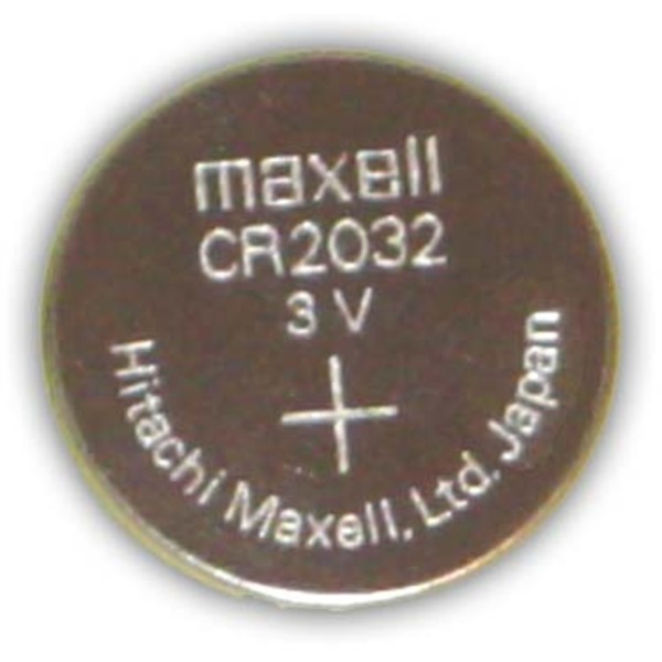

Could be more likely Bad or old CMOS battery. CR 2032 3V
Or, is this your case? Any sudden power interruptions or surges?
Computer improperly turned off
If the computer was had the power disconnected while it was still running it is possible this could cause the CMOS to become corrupt. Ensure that the computer is ready to be shut off before turning off the computer. If you have a laptop computer make sure the battery is charged before disconnecting the power connection.
If the CMOS values have become corrupted enter the correct values in CMOS setup and then save and exit CMOS setup to resolve your issues.
