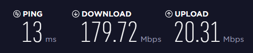

I have 180mb down and 20mb up but am getting anywhere between 5 and 25mb down on say Steam or mmo update launchers. I have never gotten more than 25mb/s even on torrents.

Forgive me if you have a solid grasp of this, but internet packaged are sold in bits. Your ookla download throughput calculates to a ~22megabyte per second down speed.

He did speedtest and is getting full speed .Its just the way steam etc converts to mbs instead of mbps.
