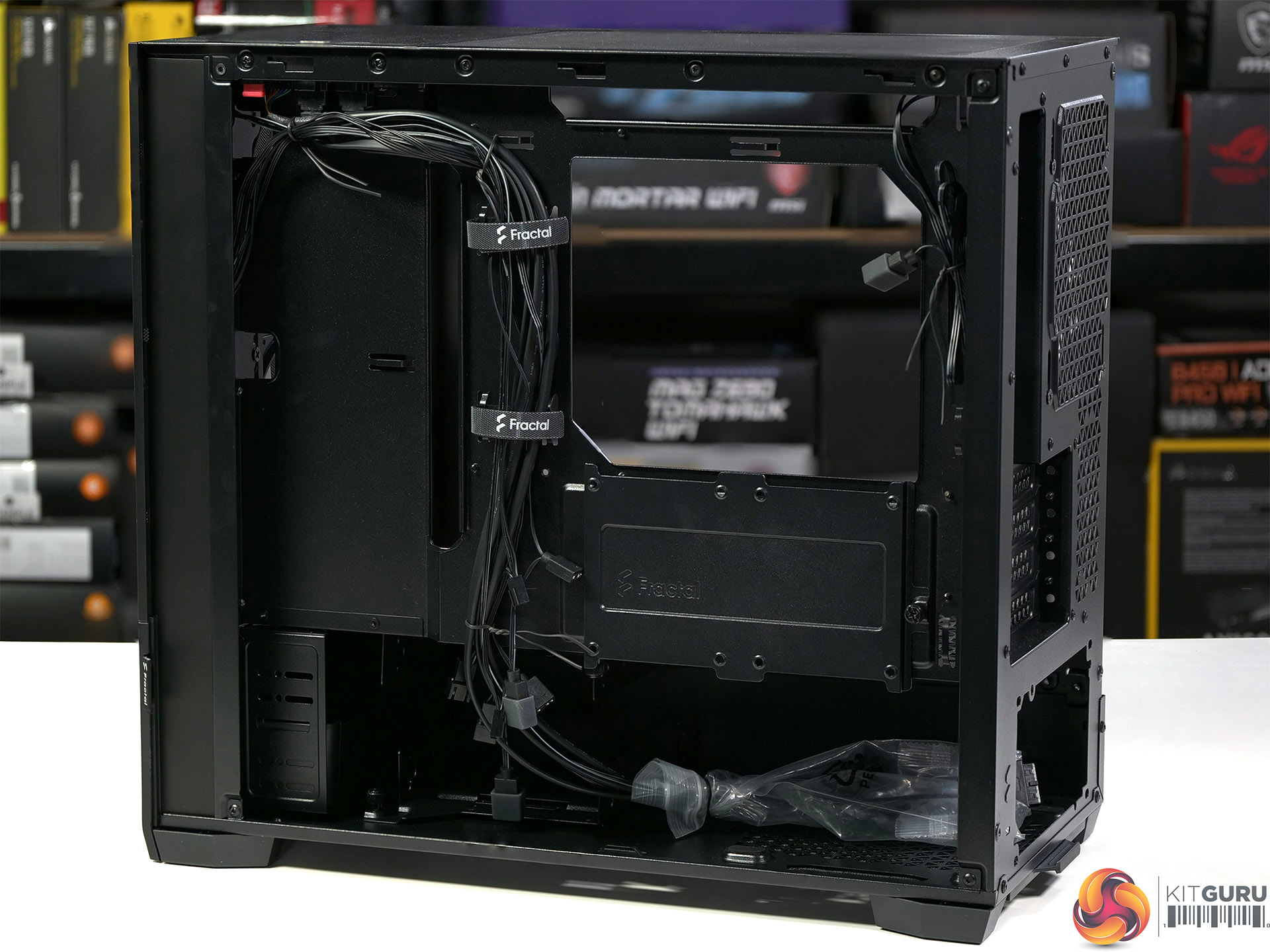

Do you know if POP MINI AIR would benefit from L shape of Lian Li?
I'm unsure about Lian-Li PSU fitting in the PC case you are planning.
Since Lian-Li PSU has L-shaped design, making the overall PSU length 183mm. Pop Air Mini specs say up to 150mm PSU. But i think it is due to the 3. 5" HDD cage in place.
On this image here:
Direct link if image doesn't load: https://www.kitguru.net/wp-content/uploads/2022/06/1-Pop-Mini-Image-D-copy.jpg
Source: https://www.kitguru.net/components/...ign-pop-mini-air-review-impressively-compact/
The protruding part of the PSU will hit the 3. 5" HDD tray, thus not fitting inside the PC case.
But you can remove the HDD tray easily.
At 3:20 in this video:
View: https://www.youtube.com/watch?v=MwWa-Lz-j9w
Still, cable management would be tedious. Since PSU is mounted fan facing downwards, the L-shape would be at the top. Best to connect all cables to the PSU before sliding the PSU in.
