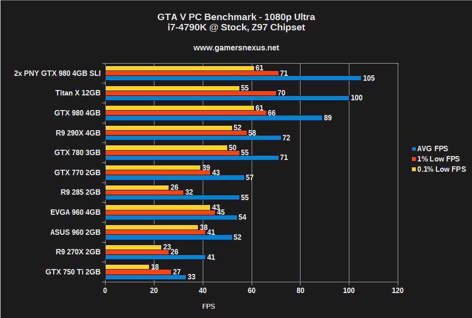

I'm afraid you were never running GTA 5 on Ultra (even at 1080p) at 150+ with a 750Ti. Look below:
My 980 won't even get 150+ at 1080p Ultra, it doesn't even average 90FPS. The framerates you are getting look about right. Your card only has 2GB of VRAM, it's not really built to run an modern games at Ultra.
Alright so probably my resolution was more low but what does it have to do with the issue im having right now? I asked why i used run games really fast and now im running them with low fps and spike lags.
