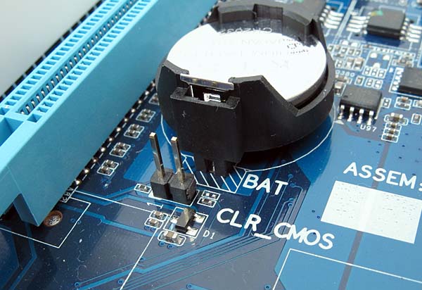

You should probably reset the BIOS with the CMOS jumper. It looks like this:
Just shut the PC down and remove that jumper (labelled "CLR_CMOS"). Start it up again with the jumper off. Then shut it down and replace the jumper. This will reset your BIOS to factory settings, hopefully clearing some kind of automatic misconfiguration.
If it uses three pins, you switch the jumper to the other two instead of removing it. If there is no jumper, or you don't have pliers or tweezers handy, you can remove and replace the CMOS battery (above the jumper in the picture) to accomplish the same thing.
