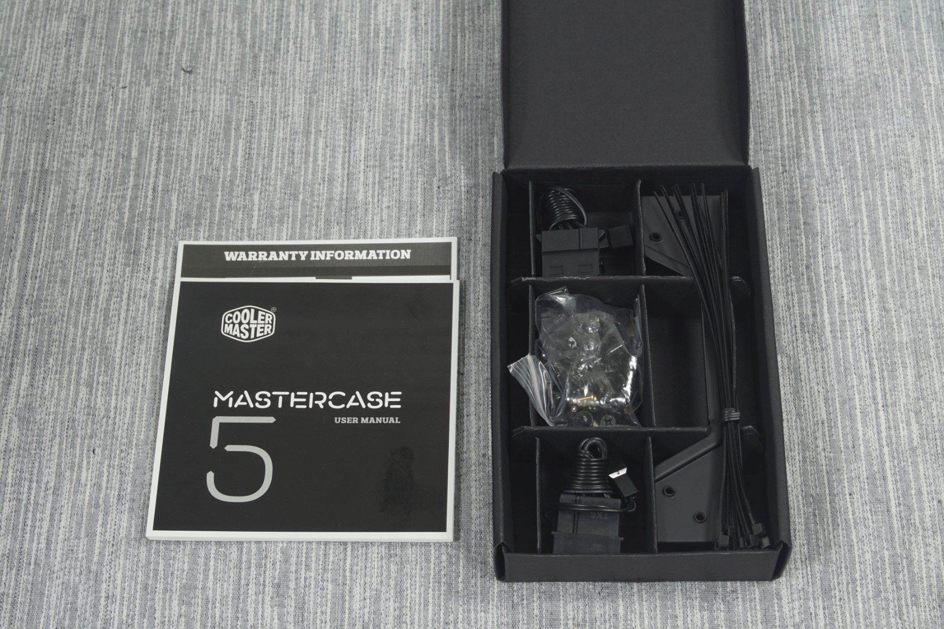

Judging from this picture
they are both molex to 3/4 pin fan adapters. They don't look like they have a separate split end that connects to the motherboard.
Can you please pass on a pic to clarify this? It's things like these that often require a picture to understand both people are talking about the same thing(or at least looking at the same thing).
