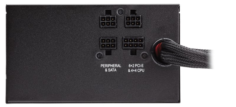

Also, with the "peripheral & sata" ports on thd psu, it doesn't matter which one you plug the sata cable in? As there are 2 above the label that look the same, but sata connection has 5 contacts and peripheral 4 pin has 4 contacts.
Yes, same apply for 24 pin ATX power connector and 6-8 pin PCIe power connectors. 24 pin connector may be tough, yes :)
Do not mismatch these. Use only SATA ports to connect drives with SATA interface.
Some SATA ports - for example SATA3 and/or SATA5 - may be shared with motherboard PCIe and NVMe slots. If you use NVMe drive or second PCIe adapter card, those SATA ports will not work at the same time. Check your motherboard manual to learn which ones are shared and use different SATA port.

I'm a bit confused now, maybe I wasn't clear enough :) I had in mind these 2 ports one the left: https://www.cclonline.com/images/avante/CX450-550M_01.png I forgot now, but I think I plugged the SATA into the top one, because I figured if the PCI one is 8-pin one at the bottom and the name is on top, then the 'peripheral', if it's different, will also be at the bottom. It seems to work though, some trouble with those connectors.
