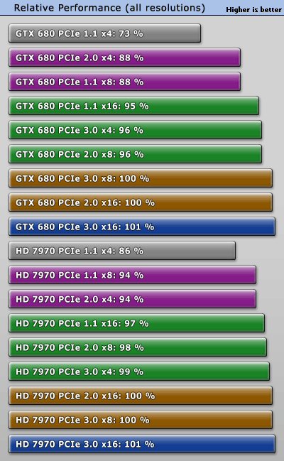

as you see
this image is comparing the difference of performance of GTX 680 on different slots
and there is only 12% Performance loss
between it on PCI-E 3.0 x16 and on PCI-E 2.0 x4
I want the same comparing but
between a R9 270 on PCI-E 3.0 x16
and another R9 270 on PCI-E 2.0 x4
to know how much extra performance I will get if I crossfired them
thanks, I hope I'm not disturbing you
Im no Expert, but i dont think there is going to be any performance loss at all.(maybe 2-3%)
as the chart mentioned by you,
GTX 680 looses 12% in PCI2.0 @4X speed. That means the 4X bandwidth is sufficient for 88% of 680.
And R9 270 performs 10%(+/- 2%) less of 680, so i think ull get 99% of 270's performance.
From my knowledge ,The 4X lanes struggles to keep up only with higher end card not with mid end or lower end.
Someone correct me if im wrong.
I was just going off the tests I performed, benchmarking my two 7950s in different PCIe slots. My conclusion was; nothing to be worried about.
