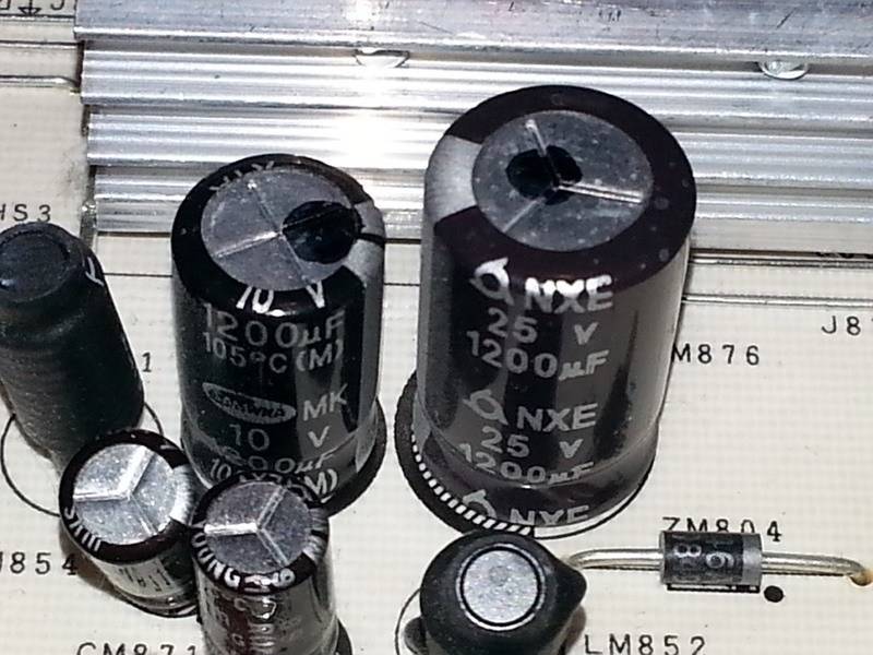

Ok. Cool. That means it's "failing", or in the process. Last time I saw this behaviour it was the motherboard. If you look at the capacitors on the motherboard, do you see any with a slight buldge on the tops?
Like this:
It may be subtle, those "lines" on the tops of the caps should be completely closed. ANY bulging or "gap" means those caps are failing.
I will see if any of those lines are in the tops of the caps but if there is, does it have any other solution than changing the motherboard?
Afraid not.... I mean.... An electronics hobbyist like myself would actually get a bunch of replacement caps off of eBay and swap them out... but even then I don't do it to "save money" retail price on caps isn't as cheap as what the motherboard manufacturers get them for and what is your time worth?
FYI: The "lines" will be there, but notice on these "good caps" that the lines are just indentations? That's a good cap. A bad cap has these "vent" and crack open.
