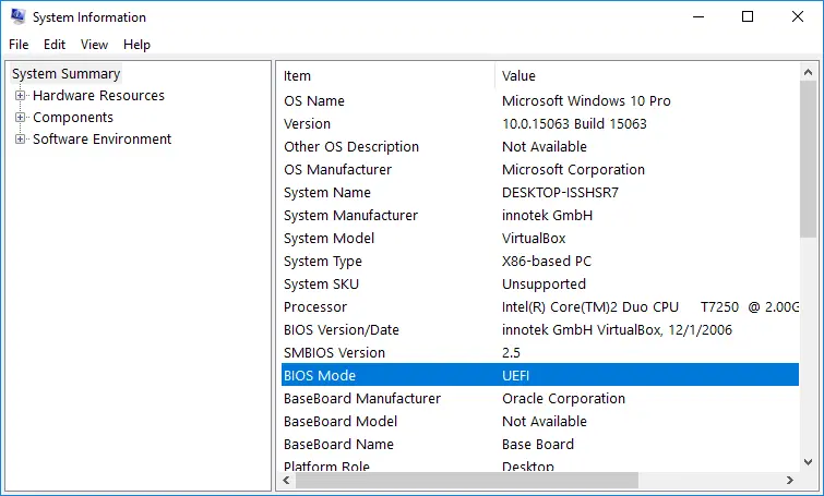

Note - do this only, if you' re absolutely sure, OS is installed in UEFI mode.
You can check it with msinfo32.
If OS is installed in legacy mode, after this change system will not boot anymore.
