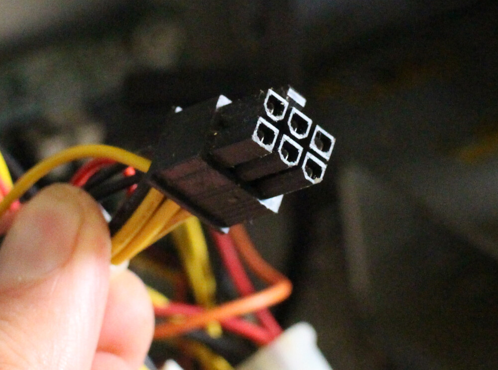

My PC has a 475W "80 Plus" power supply unit, and there's one 6-pin connector available. Guess I need to use it.

Below you can see the available 6 pin connector, which I believe can supply another 75 watts.

If a card has a 6 pin slot, you need to connect with a 6 pin psu cable.
While normally, a GTX1050ti does not need aux power, your card is an overclocked version that needs aux power.
Your psu may not be the best, but if they supplied a 6 pin 75w aux cable, the psu should be capable of delivering the required power.
It is likely that not much of the extra 75w is going to be used.
