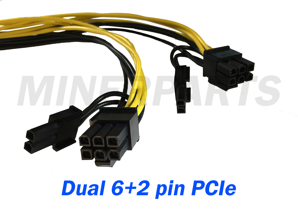

As to the 6/8 pin issue, yeah, to make them a little more universal, a lot of PSUs come with what's called a 6+2 connector. It's basically an 8-pin PCIe connector, but where the last 2 pins at the end can separate so that you can use the same wires for a video card regardless of whether it needs 6-pin connectors, or 8-pin.
Here's what they look like - in this case, it has two of those 6+2 pin connectors.
