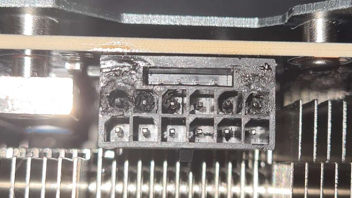

There have been problems with 12VHPWR connector on RTX 4090 cards.
If connector is not properly inserted, then it can melt and damage the card.
Make sure, you insert all connectors properly.
