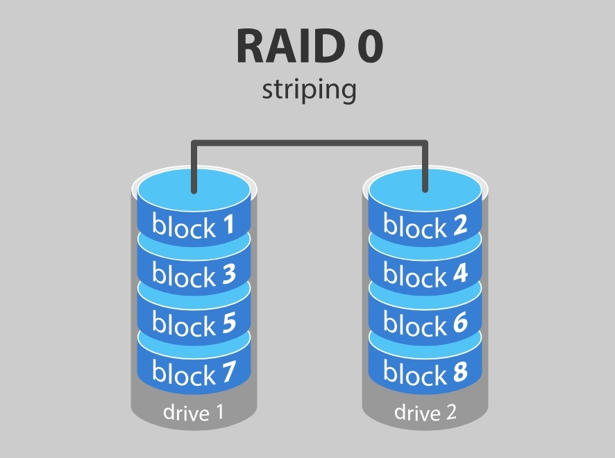

The reason why you cannot recover any data individually from either of your RAID 0 drives at home is because each files is split up into a number of equal sized "blocks", typically 64KB in size.
Any computer file bigger than 64kB is split into a sequence of blocks.
Block 1 is written to drive 1.
Block 2 is written to drive 2.
Block 3 is written to drive 1.
Block 4 is written to drive 2
and so on with consecutive blocks written to alternating drives.
In this example:
Drive 1 contains all the odd-numbered blocks 1,3,5,7,9,...
Drive 2 contains all the even-numbered blocks, 2,4,6,8,10,...
To reconstitute this file, you need to recover all the odd numbered blocks 1,3,5,7.. off disk 1, plus all the even numbered blocks 2,4,6,8... off drive 2 and interleave them to generate blocks 1,2,3,4,5,6,7,8... That in essence is how RAID 0 works.
As USAFRet says, it is often impossible to recover data from a corrupted RAID 0 array, because only half of each file, broken up into small fragments, is stored on each drive. You need both drives to be healthy to recover each file.
