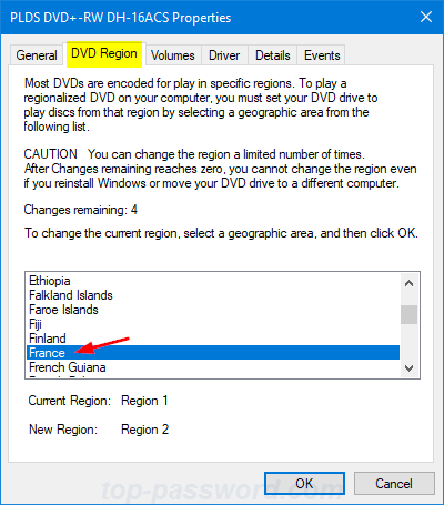

You can change the region of any RPC2 DVD drive, including externals, in the device manager:
If you look at the picture above, you will note there are a limited number of changes allowed. The region is actually stored in the hardware of the drive so if you run out of changes it will stay on the last one you set. There are some reset utilities that may allow resetting the counter to 5 again, but note that any RPC1 firmware will prevent commercial discs from playing in Windows 7 and later.
So you can either change the region of any internal laptop drive to UK and then back, or else change the region of any external drive you buy in the UK to Australia when you get home.
