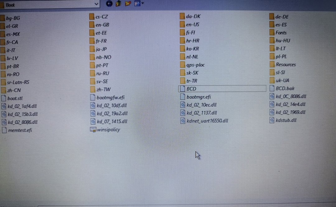

After commands it said "files created successfully". Can I doublecheck somehow?
You can try running bcdedit again, it should now show you the Windows Boot Manager and Windows Boot Loader entries. You can also check to see that there are now files in E:\EFI\Microsoft\Boot\BCD.

Right, it should just be a file and not a folder, that’s my mistake. I just remembered, I think bcdedit actually crawls through any ESPs it finds for whatever reason, so I think you might need to do bcdedit /store E:\EFI\Microsoft\Boot\BCD to specify which one you want. Is Windows bootable?

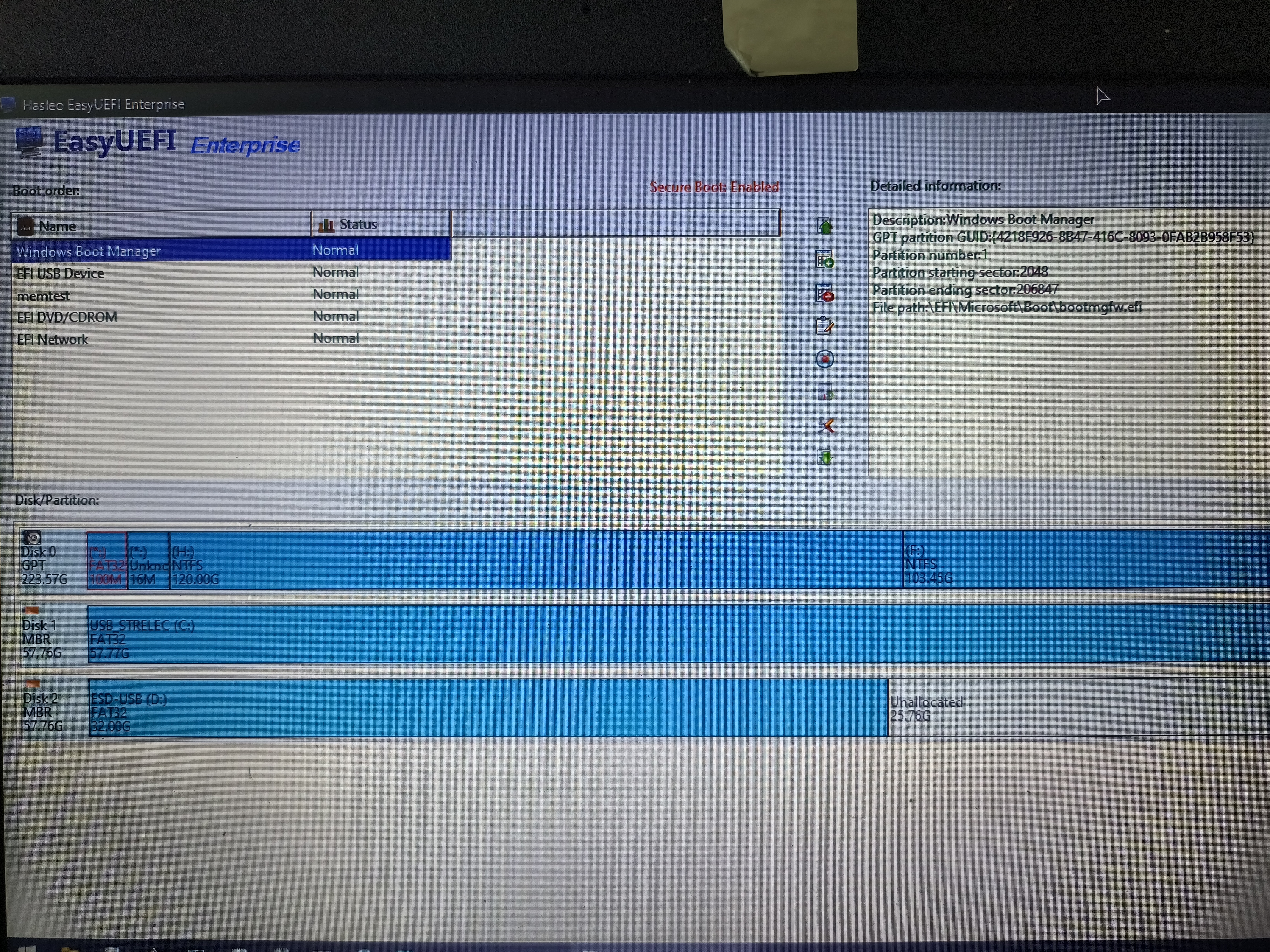

EasyUEFI says everything is normal

I'm starting to think that there might be deeper issues here. You're saying that you had a fresh disk with a new Windows installer image from Microsoft and it was stuck infinitely loading when you boot from it? What do you mean by "infinite loading"?
Dots spinning under Acer logo and nothing happens. But it's even weirder - live USB I made ,has Win10 and Win11, and if I try to launch Win10, it's same infinite loading. Win11 loads just fine, so I'm currently making bootable USB with Win11 iso
Dots spinning means that the Windows bootloader is active, so it successfully loaded the EFI binary (so probably not a BIOS issue) but likely having some issue on startup. Making a fresh install disk is a good idea, assuming that the computer meets the requirements for Windows 11. I'm not sure where you sourced your dual Windows 10 and Windows 11 drive from.
