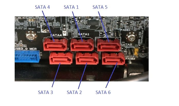

After changing the motherboard to your suggestion I was shown this message, what does this mean? And is it a problem?
The B450 Tomahawk Max has 6 SATA ports (used for internal storage drives and optical drives). Installing an M.2 SSD renders 2 inactive (just like your message states)
6-2 = 4 SATA ports still usable.
It's pretty much ubiquitous on most/ all mobos that an M.2 NVMe SSD will cause 2 SATA ports to turn off.
