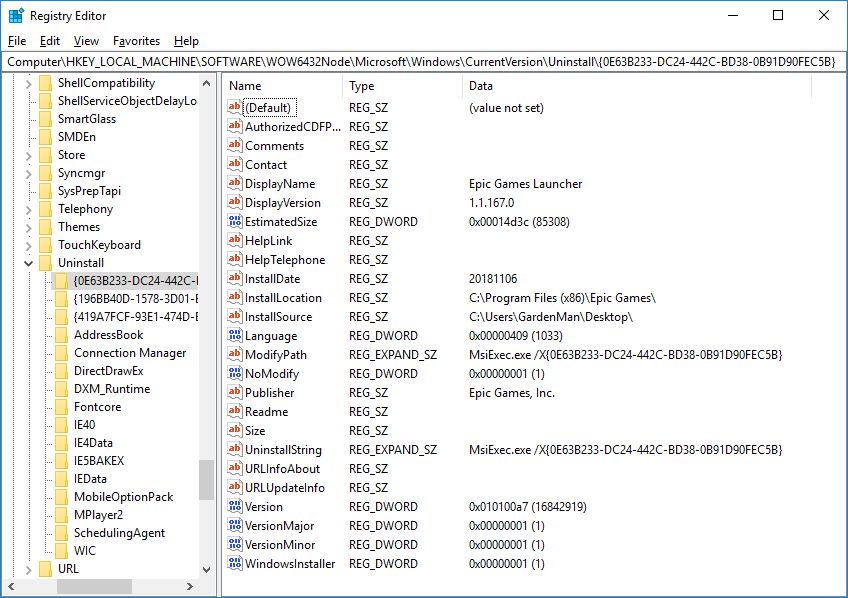

Is the launcher still listed in Control Panel / Programs & Features? It's likely this will only show up if it is still listed in the Programs & Features. Go to:
Computer\HKEY_LOCAL_MACHINE\SOFTWARE\WOW6432Node\Microsoft\Windows\CurrentVersion\Uninstall\
and look through each of the subkeys until you find the one with the DisplayName of "Epic Games Launcher". Take a screen shot of that and post it (be sure there's no private info in the screen shot).

And the registry entry that I hope you can find:
https://i.postimg.cc/vHT0pHGh/ss2.jpg
