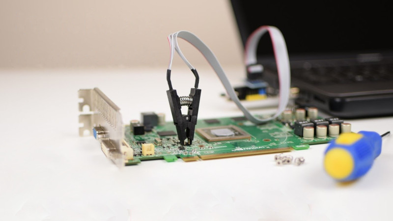

The card was flashed to appear as a different card, which was possible for some of these older models. I don't think one can flash them back to the card they should be by using the typical software-based firmware update utility though...

It's possible you could flash it back to what the GPU actually is and it would play some games and be able to use drivers from about 2018, when fermi support ended.
Overall this isn't worth the hassle and can brick the card so it doesn't work at all.

But as the BIOS showed "Geforce GTX 1050", it is still a false card right? I cannot have been taken out of a Dell machine I suppose.
