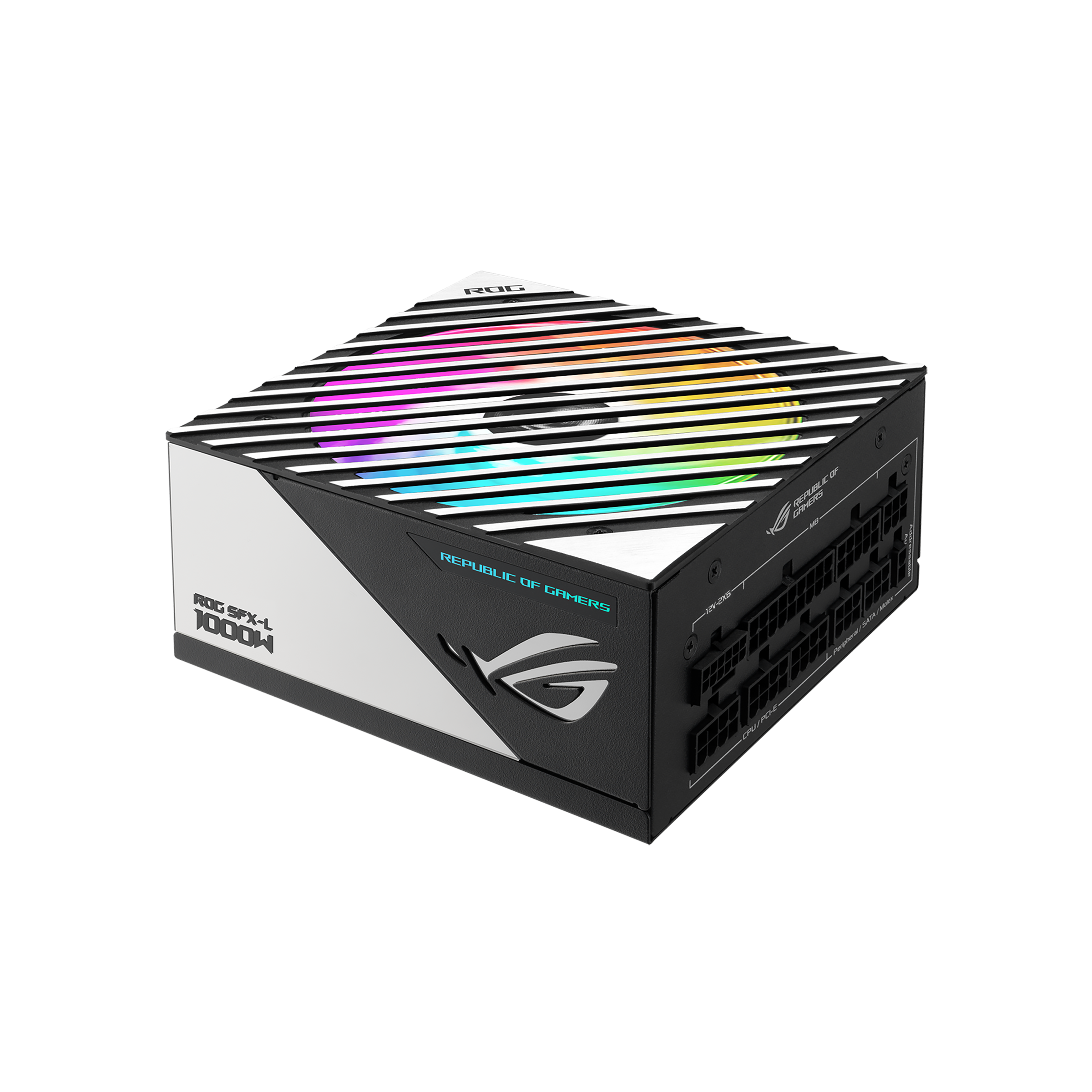

- Uses cheapo power supply

It usually takes a while for people to learn that manufacturer's warranty is a good indicator on how long they expect their product to last. That, in turn, is a good indication of the quality of the product in question.
In this case, the PSU had a 1 year warranty.
I have to agree, cheapo PSU.

Now, will Asus honor their 10yr PSU warranty... probably not, considering it's a 3rd party cable.
Considering it stated in the article:
However, their Asus ROG Loki PSU was also affected, with the 12V-2x6 connector on it also melting. u/ivan6953 even said that they suspect that the problem originated on the PSU side, especially as it seems to have been more heavily damaged.
The comments about the PSU have solid foundation.
I didn't pull that out of my britches.
I followed the links on the reddit to PC part picker, to the newegg entry:
https://www.newegg.com/asus-rog-loki-rog-loki-1000p-sfx-l-gaming-1000-w/p/N82E16817320035
Looks like 1 year warranty to me?
That's just Newegg being Newegg, ASUS' website says it does have a 10 year warranty
10-Year Warranty​
A decade of power​
We're so confident about the reliability of the ROG Loki SFX-L 1000W Platinum that we back it with a 10-year warranty.
*Core product operation is guaranteed for 10 years. The RGB LEDs are subject to a 3-year warranty.

That seems to be Newegg pulling/scraping from the wrong source. Asus' website says 10 years, and the picture of the box on Newegg has a "10 year limited warranty" badge between the "ATX 3.0 compatible" and "ASUS Aura Sync" badges on the bottom right.
There's solid foundation that the PSU could have been the issue or part of it, but you said:
:astonished::rofl::rofl::rofl::astonished:
and seemed to blame the user for using cheap components and imply they should have expected this outcome. It doesn't seem like the PSU was "cheapo" or had an unusually short warranty. Sometimes generally good models do have defects.
Reactions: TJ Hooker
ASUS doesn't make their own power supplies, they just rebadge others, and they have been known to use some really questionable OEMs (from TomsHardware's PSU manufacturer list) in the past, so I wouldn't bet money that this was made by a reputable manufacturer, especially not when proper branded units (SeaSonic, Super Flower, and Enermax) are $300+.
Although it’s a third party cable, melting at both ends looks like it can’t take the sustained load vs being plugged incorrectly, now given I forgot it’s GN or JTC who used the power measuring board found that their FE pulling more than 600W at times from that cable it’s likely just that the cable can’t handle long term spikes like that.
