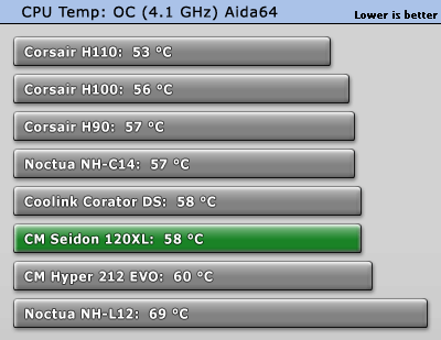

As for your experience, it must be recognized that while the Hyper 212 is a "great budget cooler", that does not make it a "great cooler". Put the Seidon up against a comparably priced air cooler and it doesn't stand up. And even against the Hyper 212, it's not all that impressive...especially when one is $89 and the other is $30
In the preceding post's image you saw the H100i, generally considered the best performing (thermally) 2 x 120mm CLC out there, getting soundly beat by the cheaper Noctua DH-15.
Here we see the Seidon 240M w/ twice the cooling capacity of the 120 model, barely edging the Silver Arrow air cooler by just 1C. The Silver Arrow gets beat by many air coolers including the Phanteks PH-TC14PE. Noctua NH-D14 and NH-D15, Dark Rock Pro, Cryorig R1

No matter how good water is in removing the heat from the CPU block, it still comes down to a metal to air heat transfer at the end (radiator of heat sink). And, at the end, it's all about metal surface area and moving air past the metal surfaces. In order to do better than the card's stock air cooler, a cooling solution must:
1. Provide more metal surface area and more fans
2. Provide more air flow (rpm - which comes with additional noise)
3. A combination of both.
