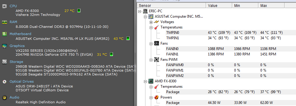

Anywho, here's a Gyazo of Speccy (just to show some of my specs) and on the right is temperatures from HWMonitor.
You can see that even though I'm at perfect idle temperatures at the time of writing (imo anyway), the Max values on HWMonitor show just how high I could have potentially hit had I not shut down my game when I had that spike.
Notice that I'm reading absurd MB temperatures (an idle of -88c?)
Restarting HWMonitor has returned my MB minimum temperature values back to normal. No clue why, but Here's the image

The numbers that HWmonitor samples come from a very simple chip on the motherboard. Any little transient jumps in the signals it reads will cause really weird numbers to come out. That's why you're seeing all kinds of just plain wrong data in HWmonitor.
For example, FANIN2 doesn't appear to have a fan plugged into it, and yet has a max RPM of 2647? And I'm sure you don't have a gas turbine or a turbocharger in your system so 675,000 RPM from a fan is completely insane.
The same thing is happening in the Temperatures section, If something was -126 degrees or 250 degrees, you would've noticed. The package temperatures from Vishera CPUs I've never really seen them as very accurate. I have a FX-9370 and HWmonitor says it's min is ~10 degrees and it bounces around constantly. I doubt it's 57 degrees in your house.
My advice is to ignore the Package temp and watch the value, not the min or max too much, of the 3 temp sensors above.
