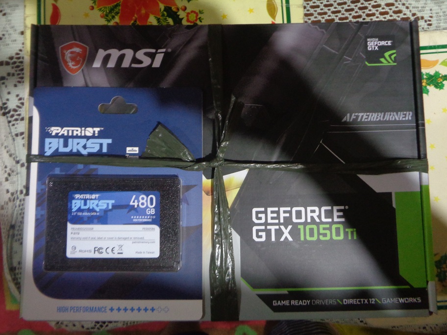

thankfully, still have not installed the new SSD I bought some weeks ago. Installed it, and put windows 10 on it. So the problem is now sort of "fixed". Can boot again, and access files in the HDD. Unfortunately, several of the games won't start anymore.. so I have to reinstall them into the SSD. Also need to reinstall NOD32, dangerous to surf without an antivirus.
saved by new SSD.
