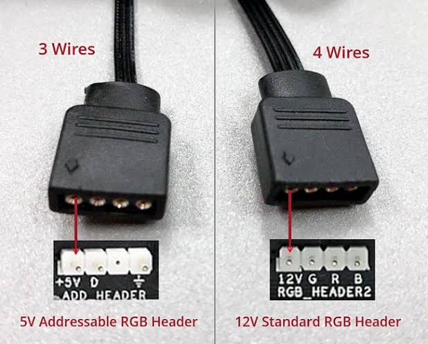

Can someone please point me into thw direction of where to find a 3 pin splitter cable for my RGB Fans I recently added two Fans to my PC. I have two slots on my control board for my Fans but only one left for the RGB. I can't find anything anywhere and I bought the wrong cable already and have to return it.
Are your fans 4-pin +12V RGB, 3-pin +5V ARGB or some other connector?
For reference, 3-pin ARGB on the left, 4-pin RGB on the right;

With this thing, all you have, is what that controller board is able to provide.
The image comes from a topic, that has the very same issue,
link: https://www.digitalstorm.com/forums/need-to-control-rgb-on-cm-fans-from-redux-pc-tidf56191/
And thus far, no solution has been found, since there is no easy way out.
This is what i'd call a "poor man's RGB", since what you have with this, is one, rainbow profile, where you can not change the profile, nor control the LEDs in any other way.
Now, it is possible that some other brand adapter might work with the proprietary 3-pin RGB header, but without knowing the exact pinout (what each pin does), it's dangerous just connect it and power it on.
Best course of action is:
  1. Be happy with what little you have.
  2. Or scrap the fans and buy proper fans, that have the industry standard 3-pin or 4-pin RGB header.
