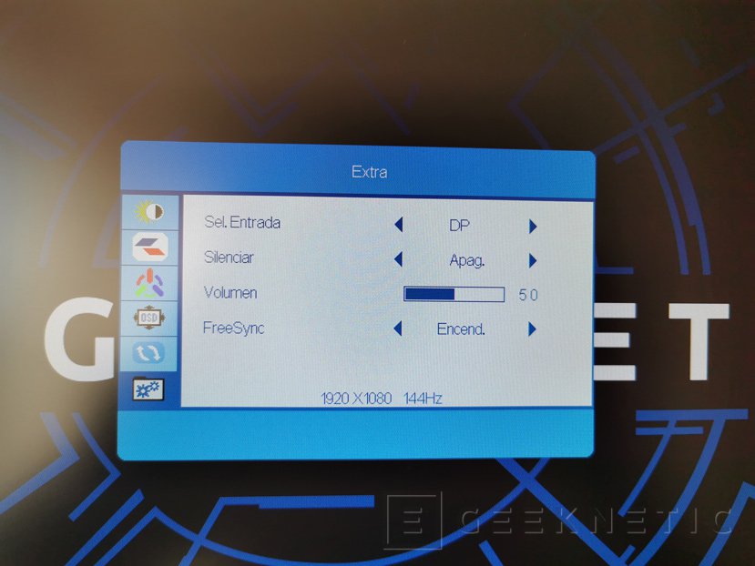

The RTX 2070 Super supports up to 4 monitors out of the box. Simply connect the monitors to the GPU then go into the display settings in Windows to configure the monitors. You can set each to work as an independent desktop or have the desktop span from one to the other. I'm not 100% certain regarding the PS4 hookup though. I read through the so called manual for the monitor and it isn't clear if you can switch between HDMI and Displayport input or if you have to disconnect one to use the other.
Reactions: helpstar
The source can be switched within the menu of the monitor
https://www.geeknetic.es/Review/1667/Review-Monitor-Ozone-DSP24-Pro.html
