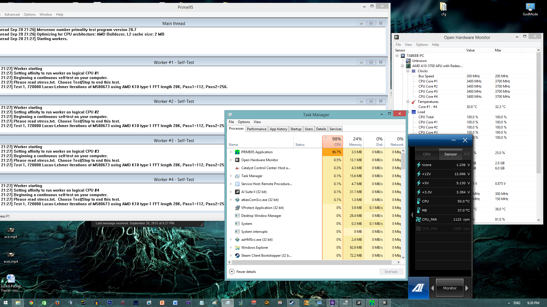

I tried to see what the temperature was in ASUS AI Suite II, the monitoring program that came with the PC.
https://gyazo.com/fb20dcc3c5e3dd3b8940393a1d8bd1eb
Too high? :/
Is it possible for me to know my true temps? I am slightly concerned about if these readings are wrong because if they are then oh my lord. What temps did I actually get before? xD

That sounds about right as well.
And actually water cooling a CPU typically produces even smaller temperature swings. It's just that CPUs can report a number of different temperatures. The two most common are Tjunc and Tcase. Tjunc is the temperature the CPU reports at the actual silicon junctions. This tends to be pretty hot. Tcase is the temperature it reports at the heat-spreader lid, or close to it. This is the temperature that most people consider to be the actual CPU temp we monitor. However not every CPU reports these the same way, which is why you get software that sometimes gets confused as to what sensors are reporting what.
