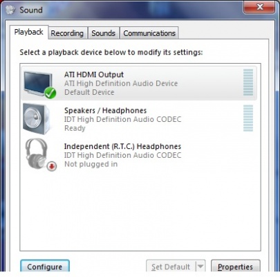

sound devices
click configure
click 5.1

Go into your Playback devices and select HDMI. Go into Configure and set it to Stereo. I know what you're thinking - you have 5.1 and all.... nope. I went through the same thing you did a few years ago. It drove me nuts. I finally switched the Configure to Stereo and now my Receiver (Pioneer Elite SC-05) will play and show whatever the source is decoded in. If it is DD or DTS, it shows as such. However, a lot of content comes across the net as two channel stereo. If you've got a source with only two channels, you'll never get 5.1 no matter what you do. Just select Pro Logic II on two channel sources and you'll still have some surround sound. Hope that helps.
Hey, I'm similarly trying to get surround sound out of my computer through hdmi. When I go to confirgue, the only option available is stereo (same window as yours with Stereo, Quadraphonic, 5.1, 7,1 but there are no options under stereo).

is hdmi/dvi output selected as default? this normally shows up as the name of your receiver in the list. is this what you clicked configure on? remember you need to have the device highlighted by clicking on it in the first image above before clicking on configure or it might have given you the configure window for lets say something like the headphone jack. double check.
