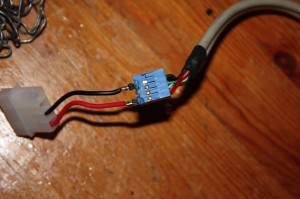

As it's an external port you could just unplug the power + ground wires from the board and wire it to red 5v and black on any molex for amperage limited by only when the wires catch on fire.

If you were going to modify your powered device anyway I suppose it could be made to rectify 120v AC like this custom Power-Over-Ethernet cable
Reminds me of this fellow who made a number of such adapters.

Now, that's a lot more than I was planning on, but now you've piqued my interest and I've been looking for a reason to buy a soldering iron, haha. It seems he did this to power a Raspberry Pi tho, or perhaps I'm misreading.
Wouldn't doing this draw the 5v and the 24 amps without any regulation? It's the voltage that charges a battery, but I feel like that amperage would do some damage, even if I can't remember how, at this point in time.
