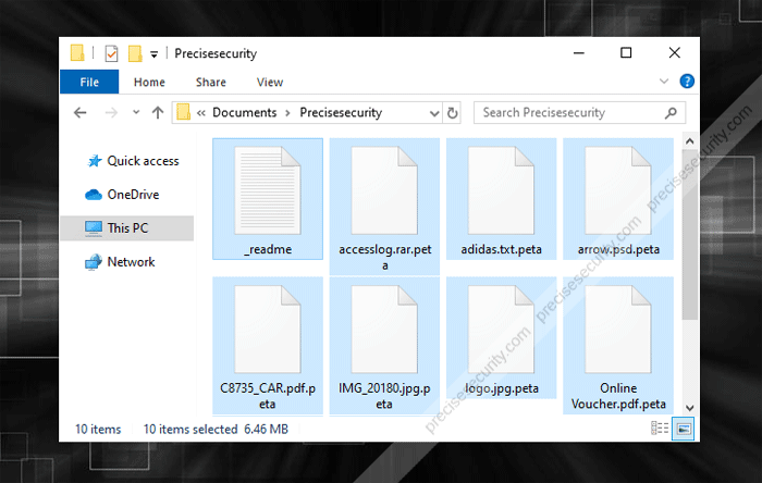

Question How to remove Peta Ransomware - virus?
Aug 27, 2019
20
How to remove this virus..easy method?
This is not a virus, it is ransomware in the STOP family of ransomware.
It appears to be possible to decrypt this, as a web search on .peta ransomware returns many results from reputable sources. See the results from:

Is it recover my photos and videos
if you were fortunate to be hit with the 1 out of 1500 ransomware variants that have been taken down and/or decryption instructions given, you might be successful. (WIthout Mr. Britec knowing the exact sample/variant you have been stricken by, it would be premature to tell you 'all will go perfectly' on getting your files decrypted)
Follow the instructions from the links previously given. (If so fortunate to get your data back, you dodged a serious proverbial bullet. If you have important/valuable files, you'll want periodic offline (i.e., not attached to computer, preventing their infection) backups as well. It's a painful lesson hopefully dodged.
