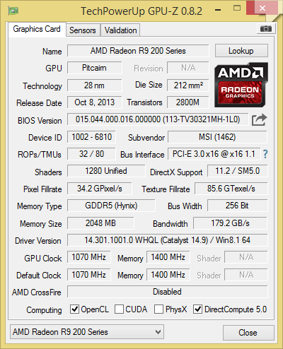

Sorry to ask you to download something else, but I'm still trying to figure out if the GPU you have is any good. Can also use GPU-Z and take a screenshot of it and upload it to a site like www.imgur.com
http://www.techpowerup.com/gpuz/
No need to be sorry >< When I get home this evening (I am at work now), I will go to that link and run the app and take a ss of it. I think I still have an account with photobucket (from my D3 days) ... I'll post asap. Thanks !
I found the boxes that the person who built my system gave me and the box is for a Radeon R9 270x MINI-ITX GAMING graphics card.
yeah Luco is right, a 270x, while not fantastic, should be enough for single client high settings and multi client minimal settings.
