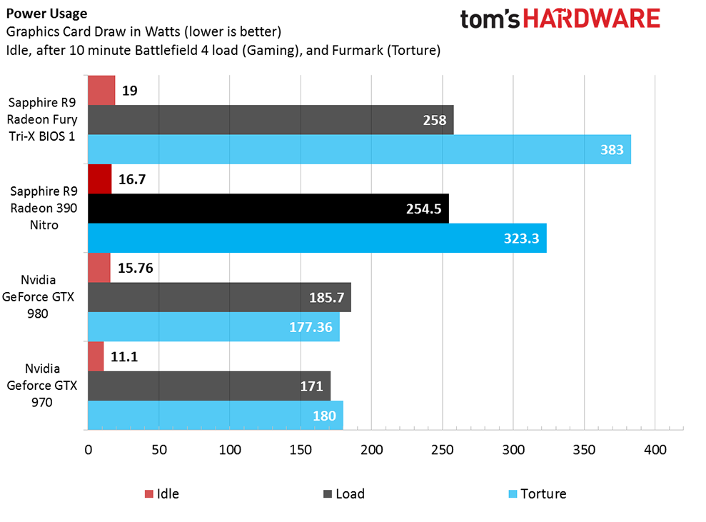

You'll have to spend a little more than 60 euro. Maybe you can find a be quiet! System Power 10 450W, but that is as low as you should go. And even that is far too close to peak demand for reliable operation.

I can't find anything in that budget that I would remotely recommend for a 390.
You be looking at €80- €100 for a decent PSU. Here are a couple of suggestions
Power usage
https://www.techpowerup.com/review/sapphire-r9-390-nitro/21.html

The danger is not that they might fail, the danger is that a failure under load will also damage all the parts it is connected to.
